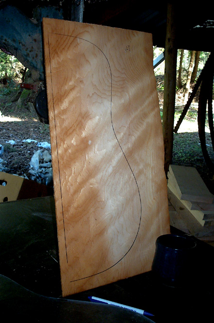

PostPosted: Tue Apr 04, 2006 4:39 am
Posts: 107
"It takes a huge tree to get totally perfectly flatsawn wood the width of
half
of a guitar back, much bigger than it takes to get a perfectly quartersawn
piece the same width."
It's exactly the opposite....
One can mill very nice well-milled slab-cut 9" wide boards from a
relatively
small tree that would never yield quartersawn material of the same
widths...
BTW, slab-sawn spruce tops have been used in the past, but is sure
isn't
something I'd recommend....
I remember seeing a very cool violin in the Ashmolean Museum in Oxford,
England, that was built from heavily-bearclawed slab-cut spruce.
The resulting top was just too cool, with the claw marks all over that
top just like you'd see in the cambium of a nicely figured bearclaw tree...
Cool look...
Here's a pic of a slab-sawn Curly Sitka top resawn from a billet that only
had a few inches of width, so it got slab-sawn just for grins.....
The bi-coloring is sun staining and not in the wood....
Interesting look, surprisingly stiff, but not something I'd recommend
using...
spruce38811.5709259259
